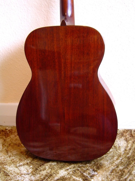

Walter, yes I'm known for my love of mahogany , and also for the old Martin mahogany guitars, of which I have several in my collection. Unfortunately, it's the sound of the Martins I like, I myself wish they hadn't stained them! I've never stained any wood or in fact used anything other than blonde shellac. I like my wood the original colour if possible. Sorry, I'm afraid to let you down but I can't really help you. If one of the other guys can't come in with an answer I would suggest giving Stew Mac a call, their technical people are usually very helpful, and can probably suggest a dye. Even so, try on some off cuts, as all wood reacts differently to dyes. By the way, is this the colour your after?

Walter, that is one of my vintage Martins ('63 OO-18). As I said above, I'm afraid I've never dyed any wood myself, just bought the Martins that colour. So I'm afraid I don't know the dye used or how to do it.

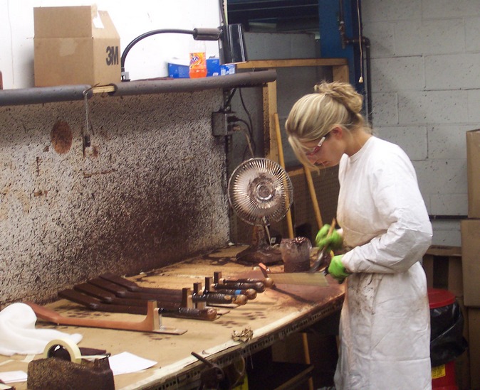

To add a to John's post, here are a couple of action shots from the neck pore filling / staining bench at Martin. I took the pictures during a factory tour last year (photographing was permitted).
Can you say messy??!!
The first picture shows the stained filler being applied. One neck waiting to have the stuff applied is natural mahogany colored, the others look like they have just been dipped in dark chocolate.

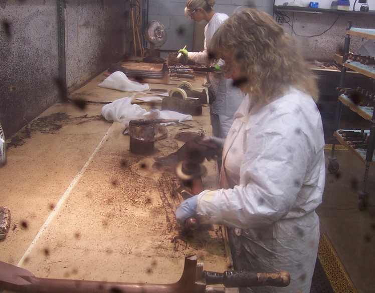

In the next picture another lady is levelling the filler (I think); some of the mahogany color comes back, but the neck is pretty dark by now.
PostPosted: Wed Dec 27, 2006 1:11 am
Great pics Arnt, thanks!
PostPosted: Wed Dec 27, 2006 5:24 am
Looks like you got right in the fray there doesnt it, judging by those pics??!! LOL
You must have got some strange looks from other members of the tour, hee hee what a die hard!
Charliewood
PostPosted: Wed Dec 27, 2006 8:16 am
Thankfully there was glass between that room and the passage where we walked! I hate to think what that stuff would have done to my camera if it had been allowed to "fill it's pores".
